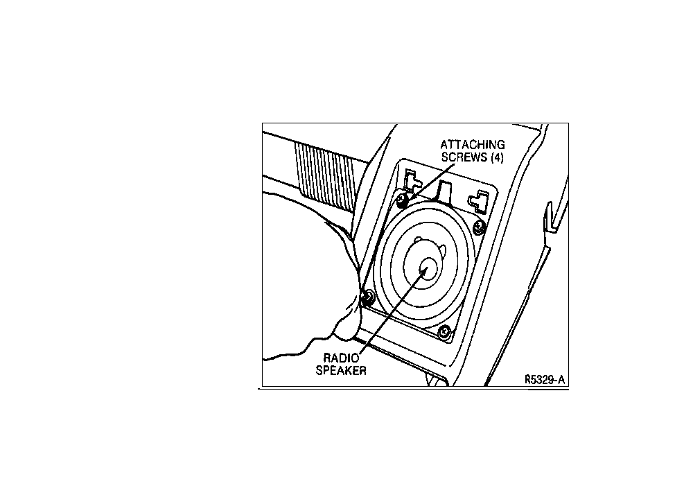

1. Using a screwdriver, gently pry out the LH and RH radio speaker grilles.
2. Remove the
four attaching screws and washers attaching the LH and RH radio
speakers.
3. Remove the radio speakers.

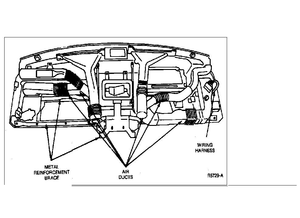

7. Remove the air discharge register attaching screws.
8. Remove the air discharge registers.
9. Remove the air duct screws.
10. Remove the air ducts.
11. Remove the electrical switches.
12. Remove the wiring harness. Refer to «Section 18-01».
13. Remove the metal reinforcement brace screws.
14. Remove the metal reinforcement brace.

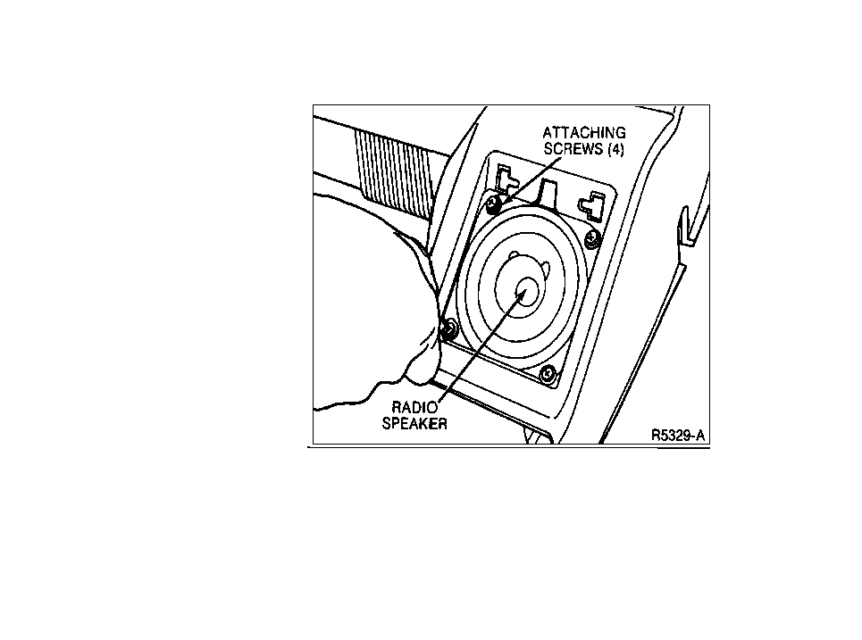

10. Position the RH and LH radio speakers and install four screws and washers on
each speaker.
11. Carefully install the LH and RH speaker grilles.
