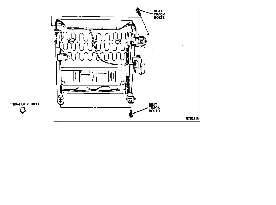

Driver or Passenger Seat
Removal
1. Remove the four seat track bolts.
CAUTION:
To avoid possible damage to seat components, handle the seat and track assembly
with care.
2. Remove the seat and track assembly.
Installation
NOTE:
Before installing the seat, ensure that the three adjustment levers move
smoothly and are not worn.
NOTE:
Apply grease to all moving parts prior to installation.
1. Install the seat and track assembly.
NOTE:
If installing the passenger seat, tighten the right front bolt of the passenger
seat track last.
2. Install the four seat track bolts. Tighten the seat track bolts to 38-51 N-m
(28-38 lb-ft).
