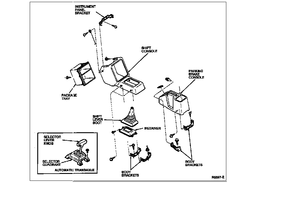

Floor Console
The floor console consists of two separate components: the shift console and the
parking brake console. The shift console contains the shift lever boot and a
small package tray. The parking brake console conceals the mechanism used to
apply the parking brakes. The parking brake console also contains the rear seat
ashtray. Brackets, attached to the floorpan, provide mounting points for both
consoles. The front of the shift console is also attached to a bracket that is
mounted on the instrument panel. With the exception of the parking brake console
body brackets, all attachment points are secured with screws.
