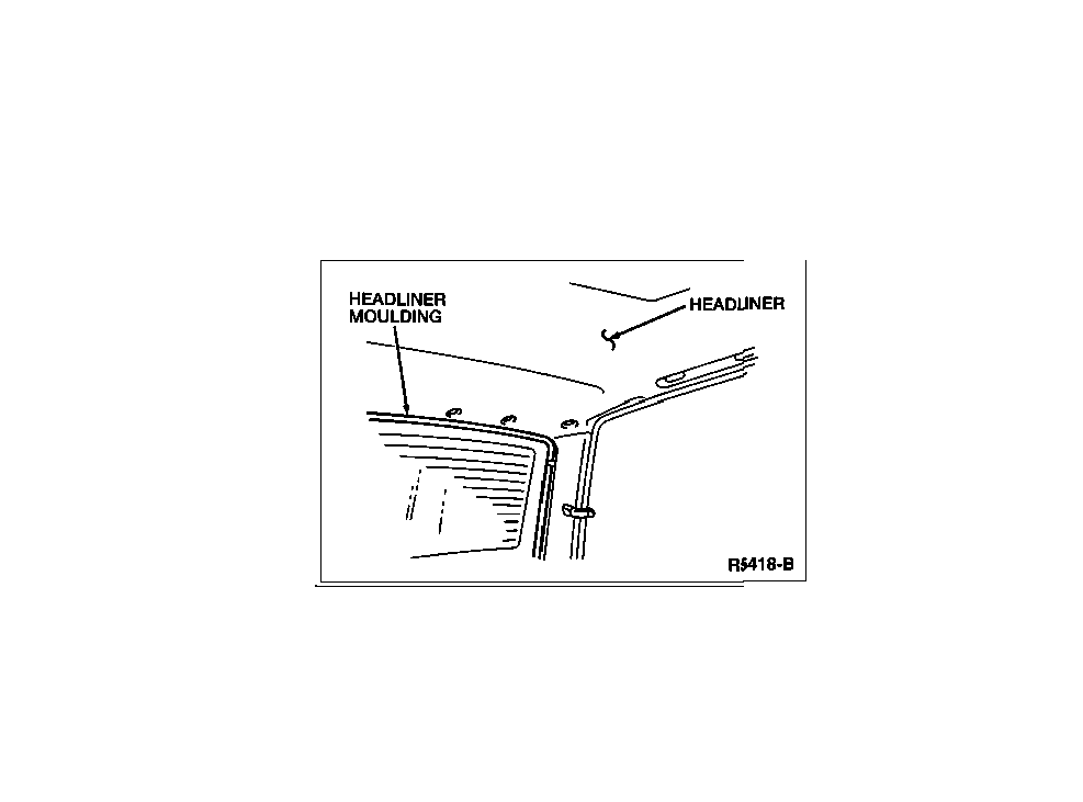

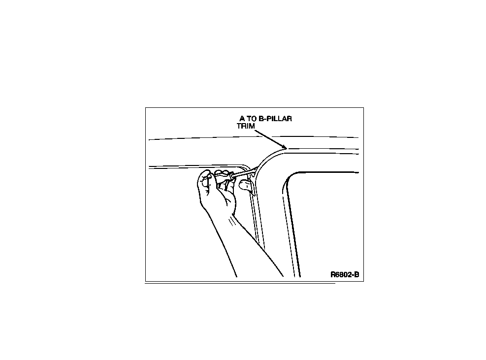

6. Using a blunt pry tool, remove the A to B-pillar trim.
7. Remove the headliner clips.
8. Remove the headliner.
9. If necessary, remove the headliner mouldings.
