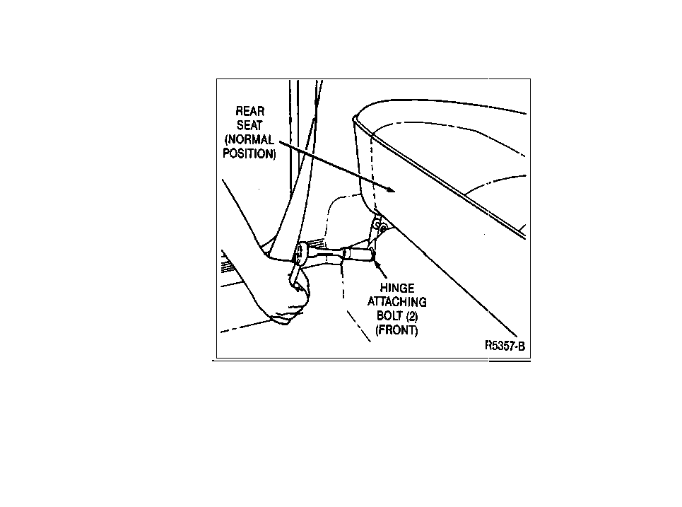

1. Remove the two front hinge attaching bolts.

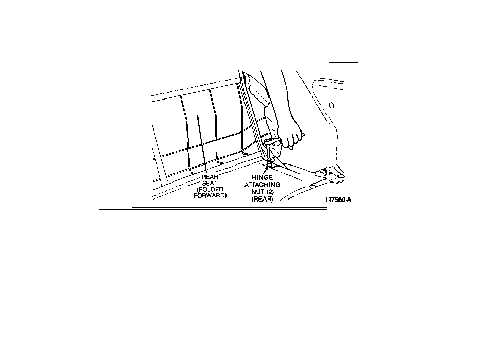

3. Remove the two hinge nuts on the rear side of the seat.
4. Remove the rear seat.

1. Install the rear seat in the vehicle in its folded position.
2. Install the two hinge attaching nuts at the rear of the seat. Tighten the two
rear seat hinge attaching nuts to 38-51 N-m (28-38 lb-ft).

4. Install the two hinge attaching bolts at the front of the seat. Tighten the
two hinge attaching bolts to 38-51 N-m (28-38 lb-ft).
