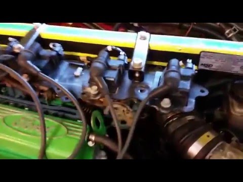

                        • racing debut

                          • This is quite impressive. Opens a whole new world for custom fueling, not just tuning, but platform and open source.
                            +1 man.
