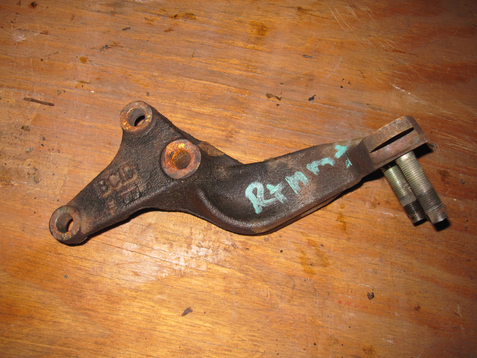

here are some snaps of the mounts.
comparison of the bolt patterns between old B6 and new sephia bracket.
bolting confirmation of intake side of the engine.
new placement of new sephia mount and original mounting bracket for original B3 passenger mount (ignore the 121 written on the mount, wreckers markings) and btw, that rusty looking ring is for the alternator bracket.
side on comparison for old and new engine mount/brackets.
side on shot of sephia mount.
new passenger mount (kia rio mount)
