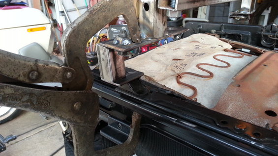

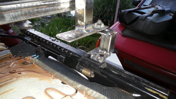

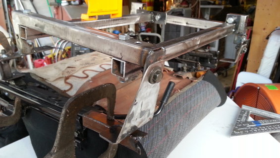

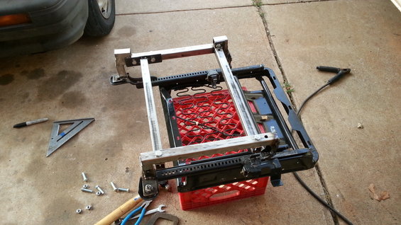

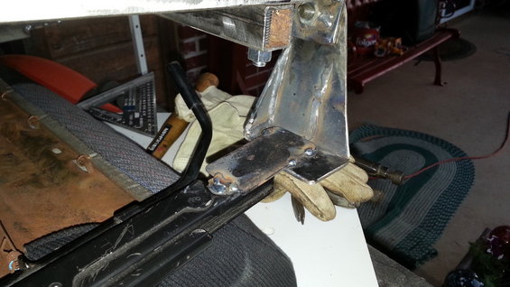

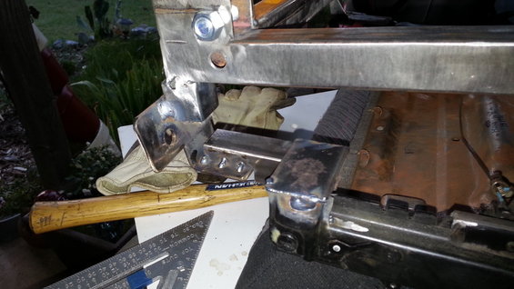

I scored some seats at PAP this past winter, but I don't remember what they're from. I want to say MX-3 or MR-2, it was small like that. I'll post pics tomorrow. This 90+ degree heat with the high humidity didn't help, sweat kept dripping down into my glasses. I think I should have welded up a fixture to replicate the mounting points, then I would have had a much easier time getting it set in place. So far I've made two front mounts that aren't yet welded to the seat, one rear inside mount that is (and was the last mount I did, and shoulda been the first) and one rear.outside mount I have to cut off.
Worked on it about 4 hours Saturday and about 2 today, and that's only the driver's side!?!
