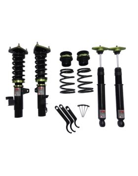

              here is a kit for the festiva. bolt on straight up
              Get top-quality crankshafts, connecting rods, and forged pistons at PPM Racing. Our cutting-edge technology, including CNC machining and computer-aided solid modelling, ensures maximum strength and weight savings. Choose from 2618 or 4032 grade aluminium alloy, with hand de-burred pistons and precision-milled ring grooves for low-drag, lightweight performance. Experience the best in design and manufacturing with PPM Racing.
              would the measurements be any help if they were still available? the item was posted on the website in 2008.
              I would say these are as close to perfection for the Festiva as they have:-
              -Pillowball mounts.
              -Ride Height adjustment.
              -32 step Damper adjustment.
              the only thing i can see wrong is no computer controlling (maybe someone could modify the EDFC unit from a set if teins to work the Damper?)
              i'll try to get a booklet or some information about these and post it up here.

                Note that it says 1998-up! And the pic shows that what is probably the rear one is incompatible. It has its own top hat. Whoever is selling this maybe meant "Fiesta".
                Edit: Contact info shows they are in Australia, so what they call a 1998-up Festiva is anyone's guess. Input from Aussies?

                    i am from Australia.. I'll see what i can do. i know a few of the Aussie members (at least one anyway).. if its a melbourne number, i'll get it... if it's a New South Wales number, i can get it unless someone closer wants to give them a call and confirm the Festiva/Fiesta?? Coilovers.

                      ^^ Didn't notice you were Aussie, jawbraeka. But my comments still stand. "1998-up" is probably a deal-breaker.
