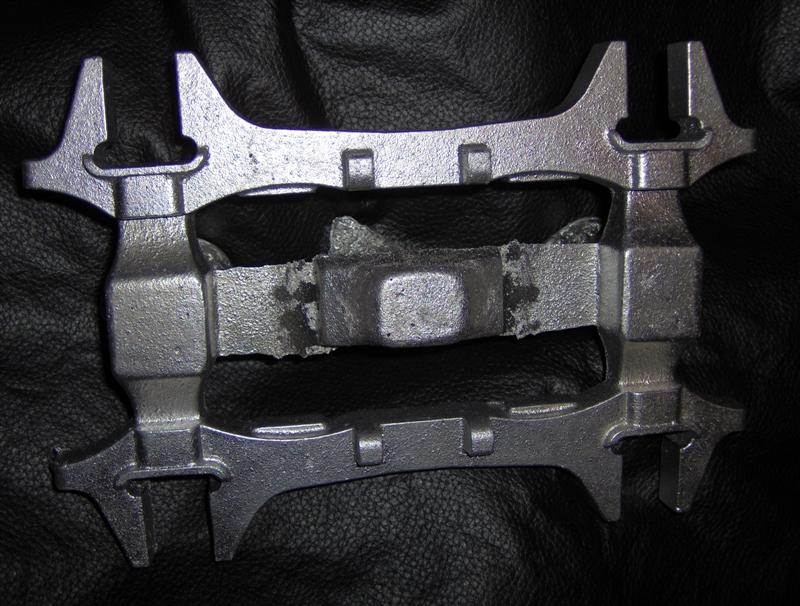

                          I have a mini shop at home I can use to make my own patterns. I worked in an iron foundry for ~3yrs, been to numerous other ones, and I've been hobbycasting for about 8 years now. I'll post some pics of my work below. At this point approaching winter it makes casting tough, but in spring I can get back in the swing of things
                          Originally posted by FestYboy View Post
                          if you could make an adapter to fit a Nikki 4bbl carb from an RX-7 (FB) i would kiss you!
                          no, wait, if you made a long tube, highrise manifold for the aforementioned nikki, THEN i would kiss you.
                          If you have the $$$
                          Here's a couple things I've done:
                          Tbird turbo inlet adapters
                          B6T intake pipes
                          Model train parts (2 trucks there, still on gating/tree)
                          Like I said, its a little tough for me to make parts at the moment but a carb adapter should be simple enough, if there is a demand then maybe we can work out a group buy or something.

                            drool drool drool Oh my gosh!!! How frickin' SWEET!! Those are awesome looking!! Great work,man!
                            Almost makes me want to change out the solid BILLET adaptor I made. :p
                            http://www.fordfestiva.com/forums/sh...t=30959&page=2
                            I think your about to be inundated with requests.....

                              I feel kind of silly. I made mine out of 3/8 aluminum using a hacksaw, a drill and a file! What a PITA! Worked out real nice though. That is some beautiful work. Wish I could do stuff like that!
                              • #45
                                zoe60, Don't feel anything but proud. There were, and still are some pretty amazing things done just the way you did it.
                                Remember the movie, The Worlds Fastest Indian.
