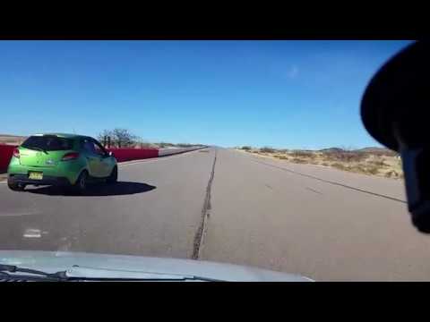

Here's a vid Joe posted from INDE. You can see me up ahead at 11:20 and 27:30, I think those shots are from the first day. My favorite part is 35:40, shot on the second day after we've figured the track out. Joe has a B6d swap so hes faster on the straights but is running Federal 595 SS tires with less grip. Our best lap times were around .7 seconds apart, with Joe being quicker.
