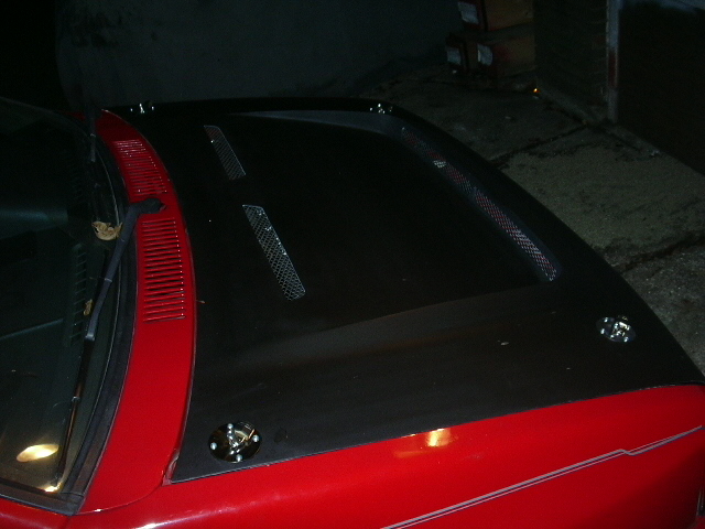

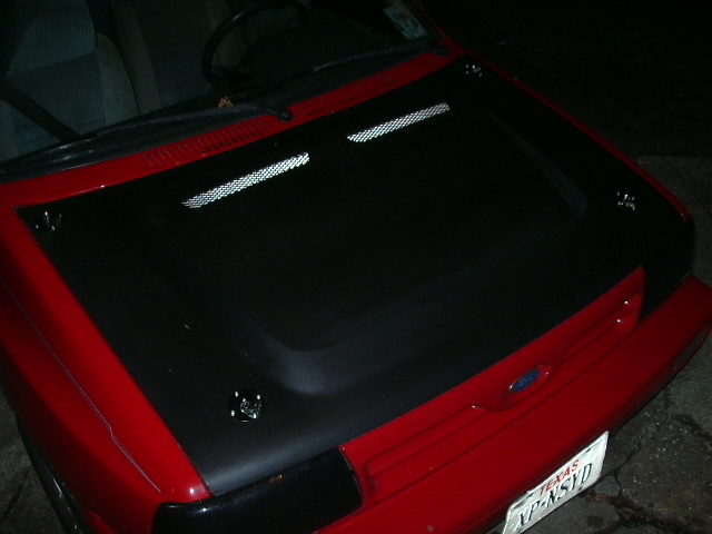

    My custom hood is on using 4 hood pins no hinges.. NO.. it's not red (not 100% done with it yet)..so it's flat black (lol what else would it be??)

          DJ - How about a shot of JUST the top hoodpins?

            ok, you twisted my arm.. here's a couple..
            The top pins are angled towards the rear.. this is so that I can lift from the front and not bind at the top. Once I lift a couple of inches, I can grab each side and just lift the whole thing off easily..

                    Well I'm not finished with this 1 yet.. there are still some flaws. That's the reason it's not red.. and actually I kind of like doing the one off stuff. Nice to have a bunch of "one of a kind" parts..
                    I've had my worries about 3 things since I came up with the mod..
                    1. The hood flopping at high speeds
                    2. RAIN on the distributor/electrics
                    3. Looks good but non-functional (no heat displacement)
                    So yesterday I took it on it's maiden voyage.. expecting the worse at 90mph.. then it busted out raining HARD.. I could barely see the road at 60.
                    If there was a test, it passed with flying colors.. because of the verticle front vents, the hood is stiff and doesn't flop at high speeds.. and even in 97deg temps the engine stayed allot cooler than usual.. hard driving rain didn't get near the electrics either.. so I say it's a success!!

                        ^^no, too much to do to get ready for a 3000 mile round trip. It's been raining off and on here for over a week. and the garage has Techno in it.. So all the work going into Zippy is between raindrops. :lol:
                        I'm still not 100% sure I will leave it on Zippy and just do another mod to Techno's hood or what.. but I had to get it on for durability testing before I go to Detroit with it on..
                        I've heard that hoodpins are illegal on the highway.. anyone know??
                        I think it has something to do with the little clips being able to be removed or work their way out. So I used 4 little Master locks keyed the same instead.
