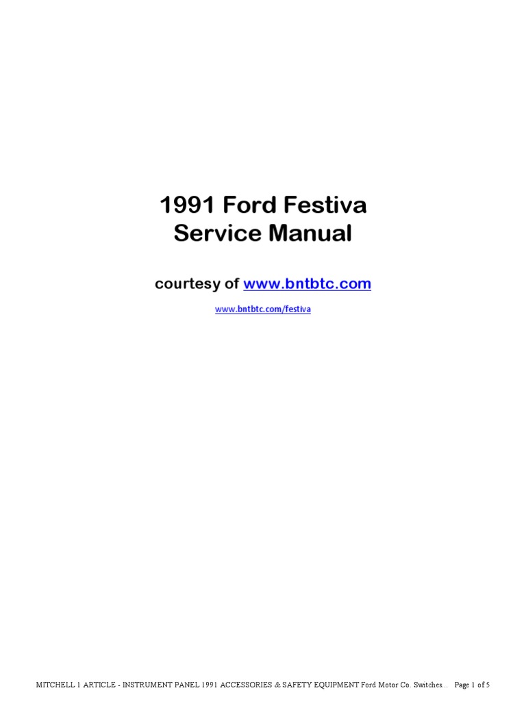

this has a lot of good info, just thought if you havent already found it.,
online manual
I think 1.3 starts at about page 100.ENFORCER - Midwest Festiva Inc., Iowa
#1 '90 Sport to modified Lx - RollazX
#2 .....Cheesehead
#3 '91 White - Donor Car
#4 .....Montana Project
SOLD----Levistiva for $1500
Bought her back for $450
Now that's darn near priceless!!
WOW! What a valuable find. It will take a while to get comfortable with it, but already I've found something extremely interesting.
In the following picture taken from page 149, they give resistances for the full range of movement of the throttle. But the footnote says, "Capri only. Festiva uses throttle position switch."
When you look inside a Festiva TPS there appear to be only two switches to signal when the throttle is fully closed or fully open. In addition, there is only one wire going from the TPS to the computer. Could it be that our TPS only signals those two conditions and can't be responsible for all the driveability problems it is commonly blamed for?
John Gunn
Coronado, CAJohn Gunn
Coronado, CA
Improving anything
Improves everything. Copyright 2011 John Gunn
yes John, our TPS only signals closed throttle and wide open throttle. However, if misadjusted, the idle switch will not close, and the PCM will increase IAC, advance spark, and raise injector PW slightly, expecting to see a significant change in VAF. All of this causes idle issues. This is because in closed throttle and WOT, the PCM is in open loop mode, ignoring the O2 sensor, and working only off of built-in look-up tables. In part-throttle mode, its in closed-loop mode, watching and responding to the smallest changes in the O2, which will drive idle to be erratic.Originally posted by JohnGunn View PostWOW! What a valuable find. It will take a while to get comfortable with it, but already I've found something extremely interesting.
In the following picture taken from page 149, they give resistances for the full range of movement of the throttle. But the footnote says, "Capri only. Festiva uses throttle position switch."
When you look inside a Festiva TPS there appear to be only two switches to signal when the throttle is fully closed or fully open. In addition, there is only one wire going from the TPS to the computer. Could it be that our TPS only signals those two conditions and can't be responsible for all the driveability problems it is commonly blamed for?
John Gunn
Coronado, CAJim DeAngelis
kittens give Morbo gas!!
Bright Blue 93 GL (1.6 8v, 5spd) (Hula-Baloo)
Performance Red 94 Aspire SE (Stimpson)
Thanks, Jim. There's no substitute for someone who really knows.Originally posted by FB71 View Postyes John, our TPS only signals closed throttle and wide open throttle. However, if misadjusted, the idle switch will not close, and the PCM will increase IAC, advance spark, and raise injector PW slightly, expecting to see a significant change in VAF. All of this causes idle issues. This is because in closed throttle and WOT, the PCM is in open loop mode, ignoring the O2 sensor, and working only off of built-in look-up tables. In part-throttle mode, its in closed-loop mode, watching and responding to the smallest changes in the O2, which will drive idle to be erratic.
John Gunn
Coronado, CAJohn Gunn
Coronado, CA
Improving anything
Improves everything. Copyright 2011 John Gunn
