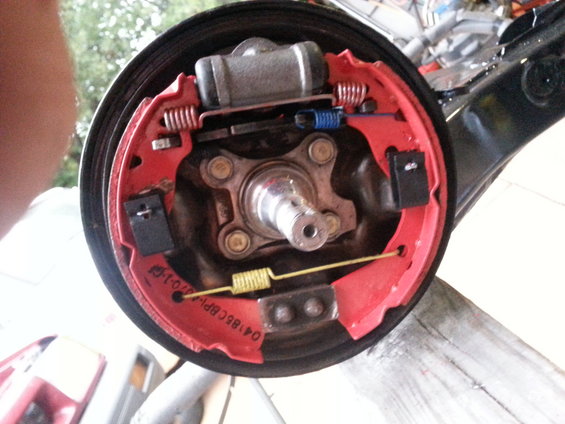

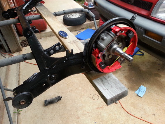

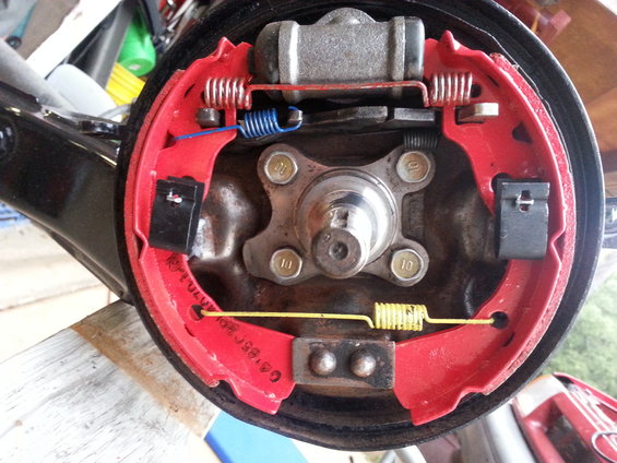

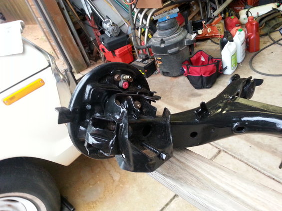

                Pics
                  Originally posted by Larry Hampton View Post
                  Pics
                  Man that thing looks nice! I can wait until I get my aspire axle to look like that. But it will have to wait until I have money.
                    Again, that's an Aspire beam, Aspire axle stubs, modified Festy backing plates and new guts.
