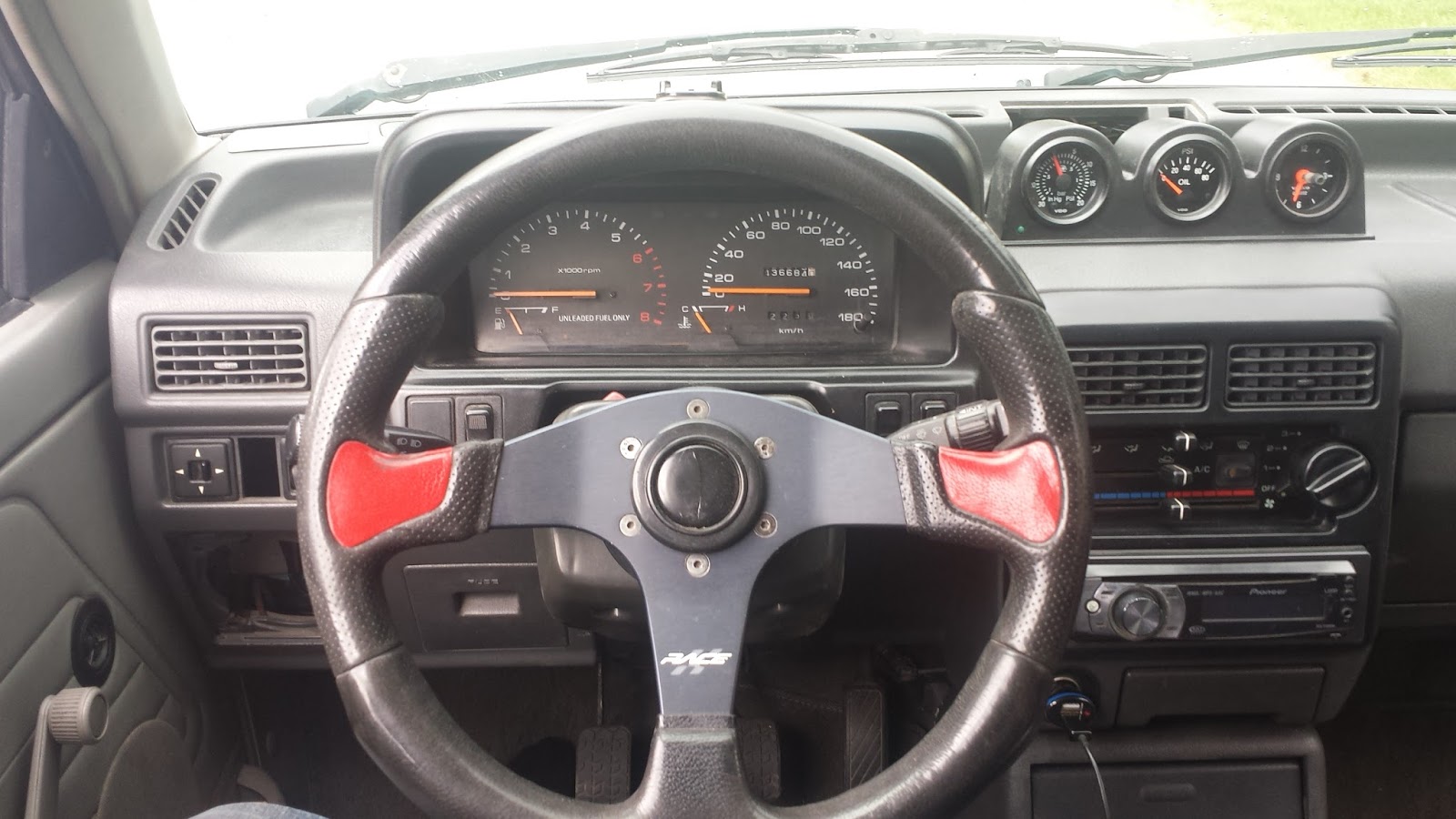

That bottom photo is the same as mine except I have a few more kilometers!
Ian
Didn't notice that at first! Would the 75100rpm redline be for the the twin cam 1.3l in the GTX and GTA Festivas?Originally posted by Dragonhealer View PostNope, redline is different.
Though I would be happy to find either!!!!
IanIan
