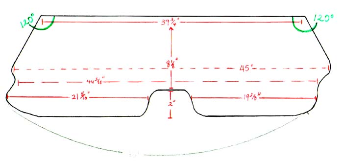

anyone have the link to the measuremnts of the rear cargo cover i'm just gonna make one!! thanks

Hows this, since I have 2 lying around I thought I would take a couple of pic's for you.
width 10 3/8
Seat side length 38 7/8
Hatch strut cut-out 43 1/2
Over all length 45 1/8, Sorry she insisted that she could be in the picture.
Brake light-cut out starts @ 18 1/4 - 24 1/2 from hatch strut cut-out

It's just a piece of 1/4" luan mahogany underlayment with strips of 1 x 2 pine nailed & glued on the edges.Originally posted by j0nathan67sweet!!! that kinda takes the guesswork out of it. i like the one dave built but couldn't find any links as to his specs??
