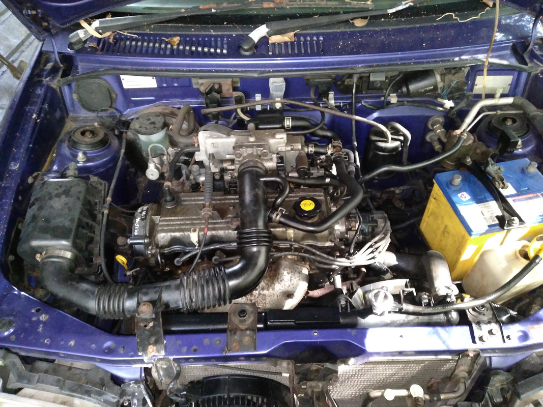

Hello , As above I have rebuilt the top end on my 1300 B3 injected engine as I bought it cheap with low milage and a blown head gasket .. I've rebuilt the whole lot of it back to fresh clean , new parts everywhere including new clutch and seals and such !

Before pull down
