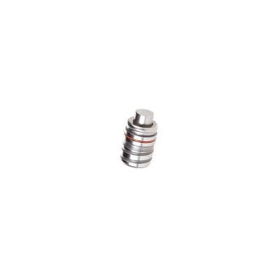

                Do you have a photo of one of them? I've cleaned DOHC HLAs but have never seen the SOHC HLAs. I have however cleaned mitsubishi sohc HLAs that may be very similar. I kept them in oil as I pressed the check ball and compressed them at the same time. Doing this several times moves oil in and out of the HLA and you can see the old oil/crud coming off.
                The mitsu HLAs have a pressed cap/ring that prevents the HLA from coming apart. If you really want you could remove the cap and clean them better since the rocker and the valve won't let it come apart anyway. They are "one-piece" so that they don't come apart during assembly of the rockers.
                  From AZ's site:
                  FWIW the HLA are the same used on the '88-'92 MX6/626 2.2L engines. If you see one at the yard grab them, takes only a few minutes to pull the valve cover and rockers and get all 12 (F2 is a 12 valve motor) and then you have a complete set for a festy AND 4 spares
