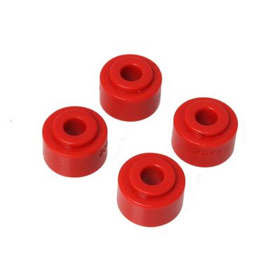

                I did mine when I was replacing outer tie rods ends so while I had them off I slid an old sway bar end link bushing from a Mustang over the rod. It was a perfect fit for the extra space in the boot. I then secured it with a zip tie.
                Here's a pic of the bushings (except I used blue ones). New Energy Suspension ones are a little pricey at $13 but you may be able to get some stock replacements for way cheaper or just look around for anything rubber that will fit over the tie rod and take up the space. Maybe a piece of thick wall hose? I didn't have to get too creative because I had these laying around but I'm sure there's all kinds of other stuff you could use. Maybe hit the hose aisle at Lowes and see what they have.
