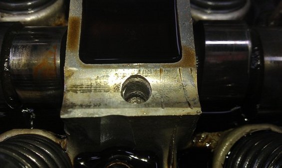

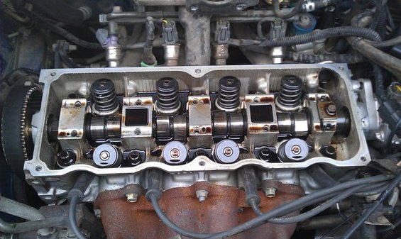

So I took off work today to try and get Thing 2 running. Now it looks like the valve cover will have to come back off. I started it up and it had a slight rattle, shut her off. Check timing, oil level, hmmm .8 low. I have no idea when the oil was changed last, and I don't have a quart of anything laying around, hey how about that jug of used oil?
Pour in about .8 and start it up, sounds better........ uh-oh, shut her off.
The back story is it got overheated, so the head was resurfaced. Now the reason it sold was because the cam retainer was never bolted down. The cam walked forward and disengaged the distributor. I grabbed all the rockers, they seemed tight. I've never messed with the top end of an OHC.
:laughing6:
Time-sert or Helicoil time.
