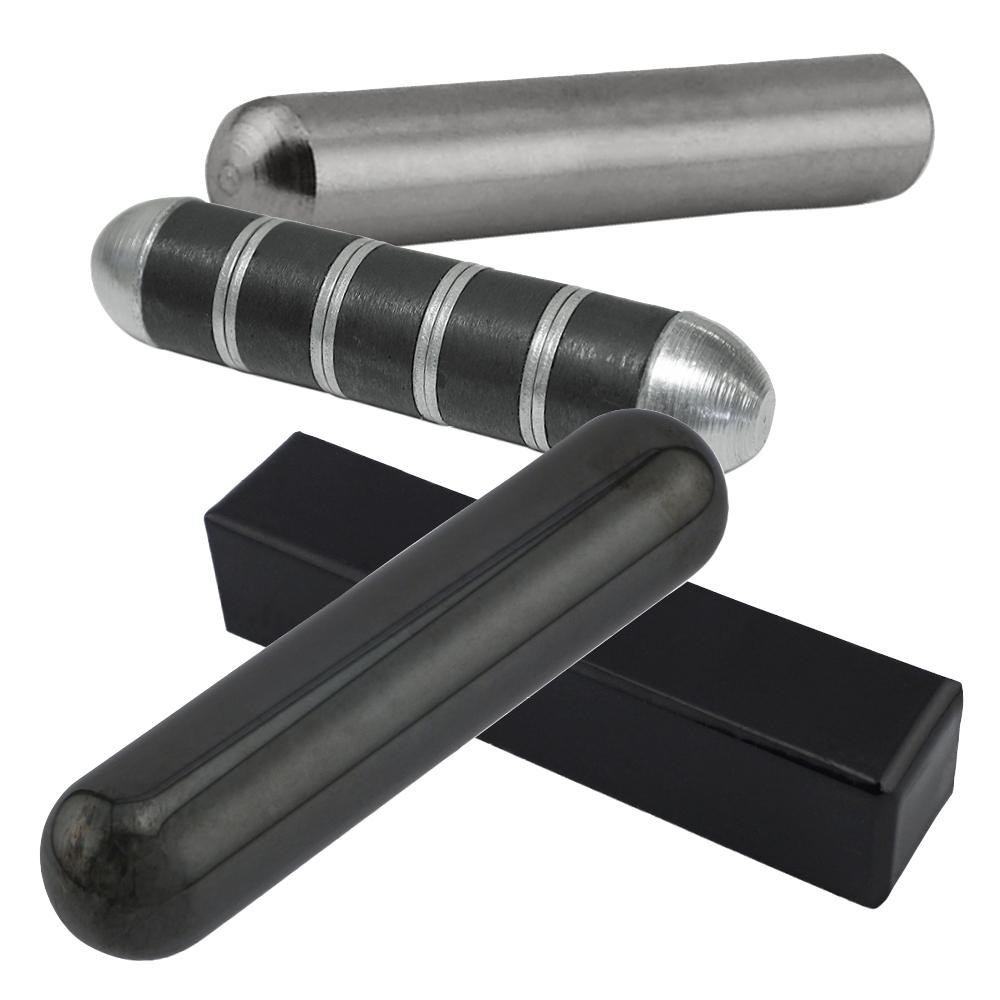

Certainly won't hurt. My dad used to use "cow magnets" and just push them up into to oil pan or trans case through the drain plug hole when he changed the oil/fluid. They are very strong with a large surface area and work incredibly well. You just push them in and forget about them.
