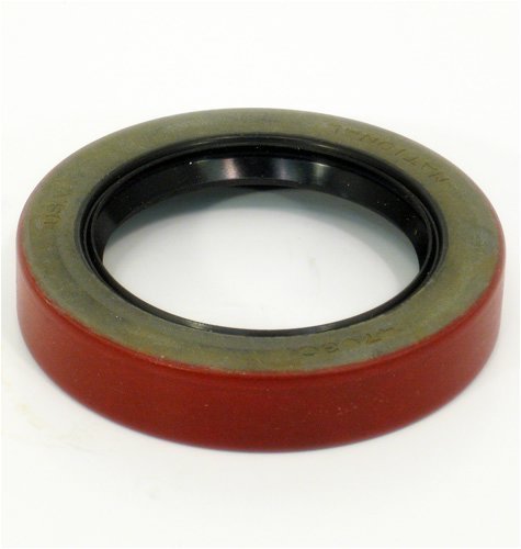

    I read a thread on here before about somebody trying to source the parts number for the replacement without buying an already rebuilt distributor but without any further replies with their progress. So far it seems everybody says that you still have to buy another distributor, I was wondering if anybody has found out the part number yet to the repair before I start calling up tons of numbers of brands who do the rebuilds.

          no , the seal that goes behind the shaft bearing.
            The governor assembly is listed for an Aspire at NOS Parts.
            F4BZ-7C053-A
            Does anyone know if Aspire distributors were the same as a Festiva?
              I have an aspire head on my festiva , so im pretty sure their identical.
                but from searching that part number on google and the price that shows up... doesn't seem to be what im looking for... all it is that I need is one of these.
                but just with the right part number that fits the festiva , the part number thats on the original seal leads to nothing and autozone's parts lookup for a swap-able part number to give it a shot is a seal thats the wrong size. Cardone replied back to me via email and said they cannot give the parts numbers for the parts they use for the rebuilds.
                Just figured it would be nice to find a replacement seal for around 10 bucks since that is all that is wrong.
                  If Kia doesn't show it as a separate part number, then I'm pretty sure Ford won't either.
                    Looks like I'm going to have to break down and get a rebuilt distributor then. Its not like I can go through all of national oil seals stock and see which would work for a replacement , too much money and time consuming and specs on them aren't always there.

                        Winfield. Could this be what you are looking for?
                        Offer the seller $5.50
                        There are also a lot of them on Rear Counter.

                            Have you tried going to a bearing store and see if the can cross it.
                              Why is that eBay part unique to the 88 & 89 though? Sounds like it fits something internal on the Carby Dizzy's....
