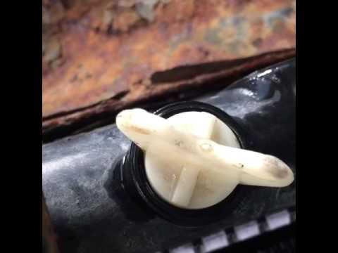

    I read all the suggestions in the low heat sticky and tried a couple of the suggestions.
    I was getting warm air out of the vents at 100F, but as the temperatures plunged it did little to warm me up. So I flushed the heater Core and then I did a coolant clean and Flush. Now I'm pumping out 130F.
    I made a video of what I did just in case anyone else wants to try it. The best part is that this only cost me $13.
