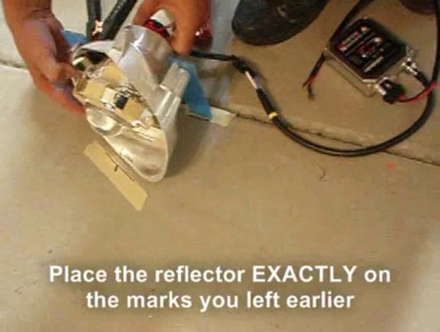

Hey guys, stumbled upon this video, and gave me a lot of ideas for custom Festiva headlights, either HID or projector. Here's the first part; it's a 4 part series, just check the related videos to find the other parts. Mad skills!!! Enjoy!!!

This is the better version of that vid, haha just watched in then. I agree about clear lenses thought about it for a while. Might just fab some up.

I know that video series and used it as inspiration for a retrofit on my '93 Grand Marquis.
I had fluted lenses so I did have to make plexiglass/lexan lenses. Wasn't hard, just had to cut the fluted part off of the lenses and epoxied on a flat plexiglass piece on in place of it. I used a thick adhesive backed plastic that's made for headlights called lamin-x to keep it from scratching and yellowing.
Anyways, after that, it was just a bunch of cutting and bolting and fabricating: that was all before the Morrimoto Mini came out... wish I could have waited.
It'd be easy for you festiva guys to retrofit projectors. The Morrimoto Mini's bolt into an H4 bulb hole and perform as well as OEM projectors. Relatively cheap too...
