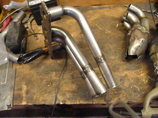

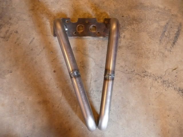

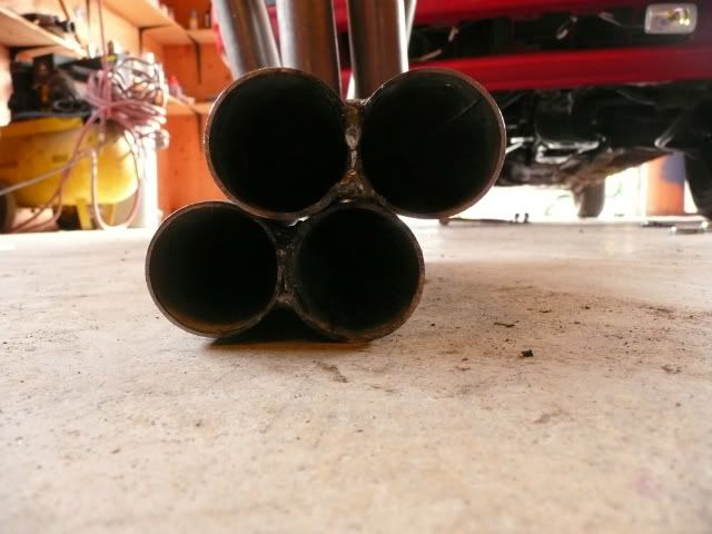

ok i got some pics. not many but you get the idea...
first i cut out the flange:
then i got the #1&4 tubes welded on:
then got #2&3 on, and tube extenders on too:
then i messed up and welded the tubes on the wrong side so they hit the oil pan, i beat it with a hammer and that did nothing...
so i cut off the 2nd set of bends and welded a pice of 2.5 inch piping in the same place:
then i welded some bungs in for my egt gauge and 02 sensor:
and they where done

Nice job!!! how does it run on the car? any issues? Powerband? notice improvements? or negative outcome?
Either way, They definately look better than stock!
P.S. What engine is that for? and how did you cut the holes in the steel plate? torches? plasma?1990 Festiva
- 5 spd. swap
- B6 SOHC swap
- Custom Interior
**********Currently Under MAJOR Reconstruction
it runs good, some hp gains (i would say 5 to 8 hp at the top end and a little less torque at the bottom) and a wicked sound
  i used a plasma cutter for the big holes and a air dremel to smooth out the holes. if i did not weld the tubes on the wrong side the would have fit (still kickin my self for that...) and i think they would have sounded even better
