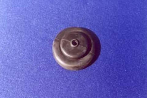

I found a source for a twin choke grommet (#1806):
