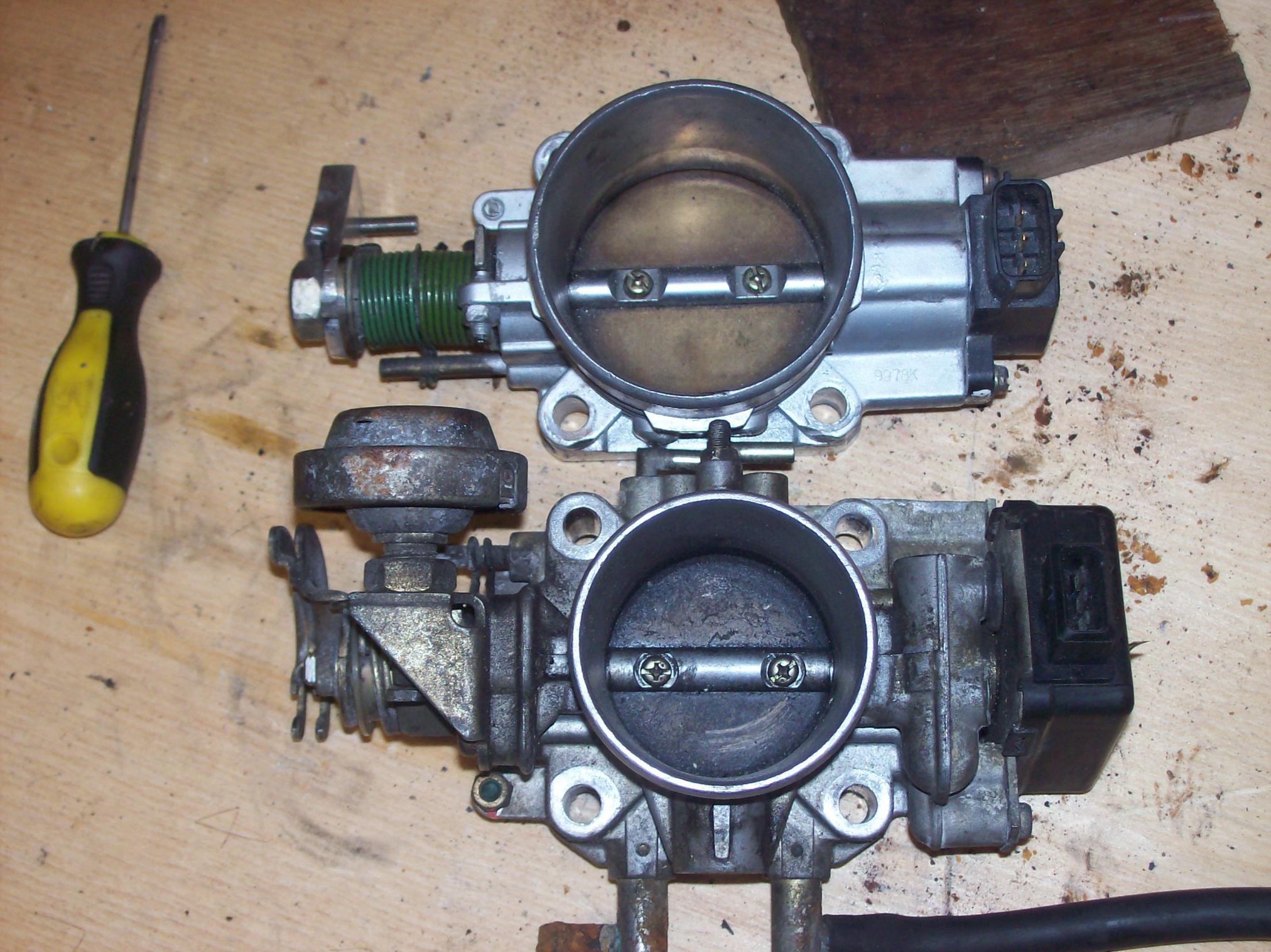

      Now I just have to figure out that SR20 Throttle Body swap...

        Originally posted by Aaronbrook37 View Post
        The Rocketman comes to the rescue once again. Cash/Paypal in hand for one of these thermostat spacers so long as you have pictures and installation instructions. I've got a guy making the spacer as we speak and sasquatch already has some Teflon I can purchase, so I'll go DIY and make a nice thick one! Sounds like a fun project though for sure.
        http://www.clubprotege.com/forum/att...1&d=1287804743
        wow interesting, im wondering if that throttle body could fit on a miata!
          Great question. I wish I had more junkyards closer to me so I could find out! Looks like the NX2000/Sentra SE-R/G20 all share the same throttle body.
