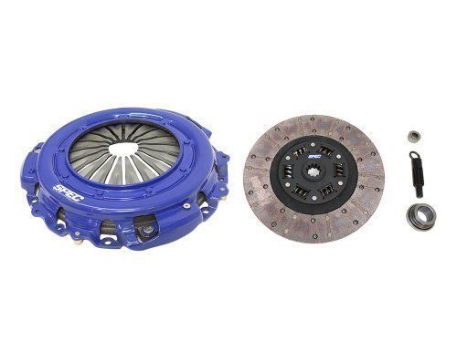

This stage 2 clutch kit is $233.09 including shipping.
I know its far away from the $130 but they're out there.
Online you could also find the seperate components.
I.e. the stage 2 clutch disc by itself is $99.
Stage 2 pressure plate $129.
But I think you would want them both since the pressure plate would be providing the extra clamping force
While the disc would create more gripping force..
So the kit would be the best option.

Features segmented or full faced pure Kevlar disc with steel backing. This lining features excellent drivability like the stage 1, but offers slightly longer life and higher torque capacity. The hub is double sprung with spring cover relieves for flexibility and heat treated components for strength and durability. BestLast edited by rmoltis; 01-08-2014, 04:16 PM.
Yea aspire and Festiva clutches are one and the same. E series trannies.. Was hoping there was a whole kit I could buy for a reasonable price. Guess not. I forgot about clutchnet, better check their prices.2008 Kia Rio- new beater
