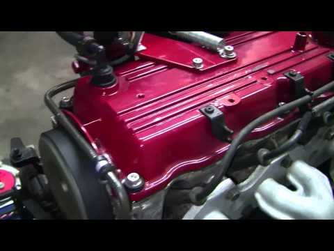

Hi 'ya folks,
Just a quick update on the dyno.
Yesterday I finished all the mechanical fabrication and did some basic testing. The dyno works great!
I controlled the throttle and applied the load by hand during the basic tests, but I'll have the electronic controls working in a few weeks.
Check out the short video http://youtu.be/aDjlQ_dsOOU?list=UU_...ygjbKQGjXB1f4g
Jim
Hi 'ya Bhearts,Originally posted by bhearts View Postlooked like you were reading timing advance numbers. i dont expect your output to be calibrated to horse power numbers. but itd give you a great reference point for upgrades
I was running 12% throttle opening and seeing what happened.... sort of looking at everything at once.
The dyno is configured with a torque arm and I'm assembling a RPM pick up point at the pump input. With torque and RPM the horsepower can be calculated. Right now I have no feedback but I'll eventually get it all instrumented and should be able to show real data.
The load is controlled by turning the knob on the big blue box. I'm converting the knob from hand control to servo control so everything can be controlled with a computer.
When the electronics are complete, I can run a pre recorded profile and find the best tune for maximum power and maximum MPG. The MPG is what I'm really after but I also want to get the best performance as well.
I think eventually we will see a lot of useful info that this forum can use.
Jim
