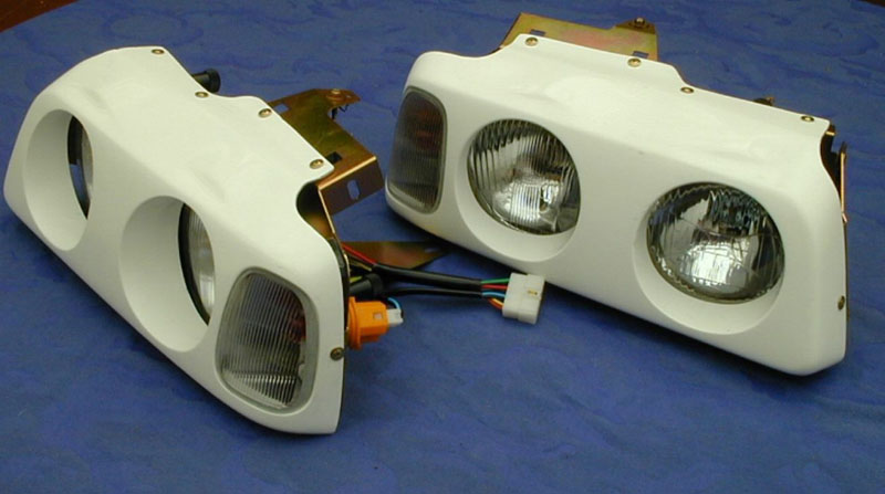

          someone made this conversion a long time back and had it in the FS forum. i was hot for the round look then and bought it but never installed. still need lens which i may have to make trying my luck at vacuum forming. i can't find the old post but i think the seller just tacked some VW buckets onto the festiva mounting plate. the headlamps can still be adjusted.

                Here are a variety of conversions. If you have any questions about a specific one, I can probably find more info about it.
