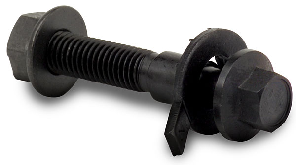

Originally posted by 25HorseplayThey sell camber bolts to adjust camber on our cars. Just check Rockauto.com for them
I'll try to get a pic up when I find my camera
EDIT:
Found them on TireRack
>Link to Page Here<

Do I get camber bolts for the Festiva or for the Aspire? Or does it even matter?5 Festys and counting!!

You should Order them for a 1994 Aspire, but If I remember right the mounting off the strut to the hub are the same size, that would be something to check out

the only other way to adjust Camper besides a camber bolt is to loosen the strut tower bolts in the engine bay (or cargo area) and move the whole tower and wheel together
