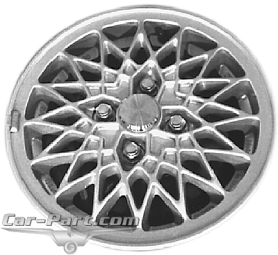

          Here's something similar. Fairly common and inexpensive too.
          They are 13" x 5", 4 x 100mm bolt pattern and +45mm offset.
          They have the Aspire sized center bore of 54.1mm too.
          They came on late 80's to early 90's Toyota Corollas.
          Festiva: Because even my dog can build a Honda.

                Originally posted by JPT View Post
                ^ Good deal.
                Definitely like those too!

                • #23
                  I doubt it... maybe some small rear spacers, but that's to be expected. Plus they're pretty cheap anyway.
                  1988 Chevy Sprint Turbo 997cc
                  • #24
                    14 X 6" with 32mm offset sounds good. If anything, the lesser offset will push the outer rim nearer your fender lip. But unless you run wide tires that may not happen. I'd like to see those on a Festiva!
                    In comparison, Miata 14 X 6" wheels are 40 or 45mm offset. My VW alloys are 13 X 5.5" with 38 offset and they fit really well with my old 165/70s.
                    I'd go with the cheaper 14s and see how they do.
                    I'd like to find a set of those Corolla mesh wheels if they're not too heavy (no more than 13 pounds) or costly. My VW alloys are a bit heavy at 15 pounds each.
                    Karl
