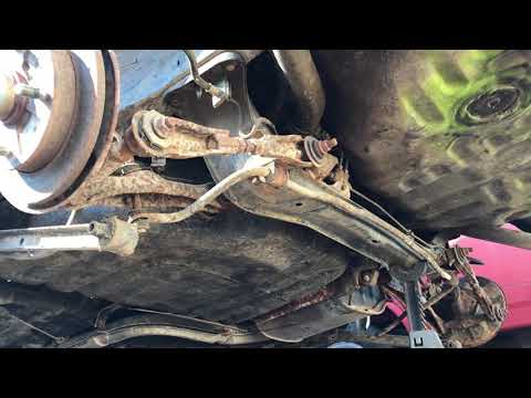

              I just got under my capri today (bought a '92 Capri btw guys) and noticed it has IRS. Definitely not a turbocharged XR2, I triple checked. Definitely nothing like the Festiva's torsion beam set up. Lots of fabrication for sure!

                            It's more independent than any "true" independent rear suspension car that has a sway bar. You need to look into who posted the quote you disagree with...
                            This is a '91 Capri, with independent suspension. The sway bar transfers much more movement from one wheel to the other than the Festiva beam does.
