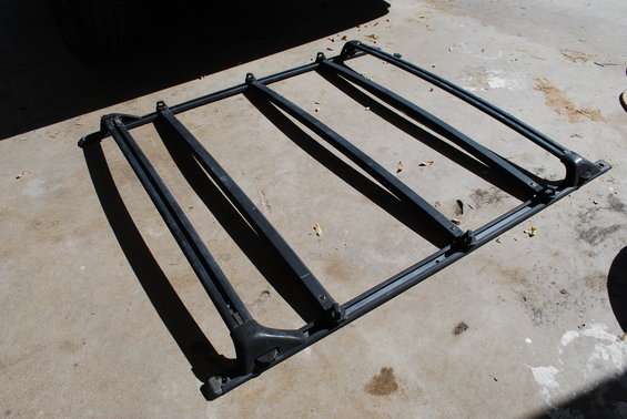

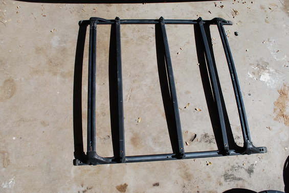

And now for my roof rack. I found this rack on a '89 or '90 Toyota Corolla wagon. It had a mid '89 build date so I'm not too sure on the year. I'm pretty sure this was a factory rack as the hardware holding it on was 5mm and used aluminum rivet nuts in the roof. I can easily get metric replacement hardware, but not metric rivet nuts. So I swapped the hardware to 10-24 stainless with aluminum rivet nuts so that I don't have to worry about the hardware rusting. Also on a side note, I currently do not have a headliner installed so this made installation that much more easy.
Here is a picture of the roof rack.
Another shot of the roof rack.

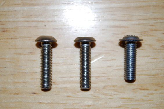

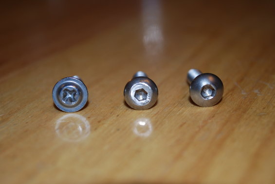

This is the hardware I used to install the rack. Six aluminum rivet nuts, four phillips head machine screws, and two button head allen head machine screws. The outer four screws used originally were 5 mm machine screws and the two inner ones were a stepped screw for clearance reasons.
Here you can see the face of the original center screw and the button screws I replaced them with. On the left is the original screw, the center is the shaved down button head screw, and the right is the button screw in its original form.
A top shot of the center screws, left is the original button screw, center is the shaved down button screw, the the right is the original stepped screw.

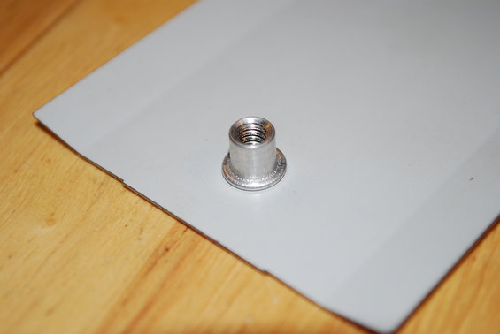

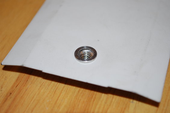

A scrap piece of sheet metal I tested one of the rivet nuts on.
A back side shot of the installed rivet nut.

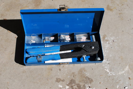

My rivet nut install tool.

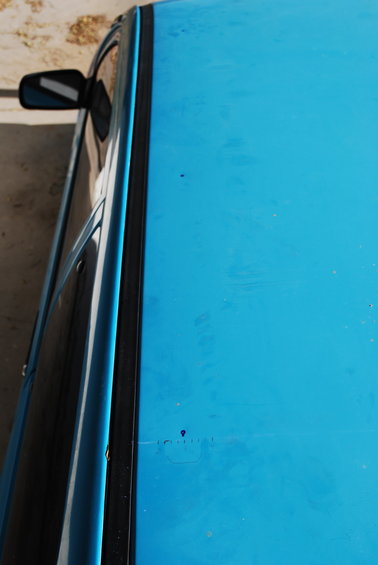

Here is a picture of the roof with the holes marked in purple before drilling.
Left side of marked holes.
Right side of marked holes.

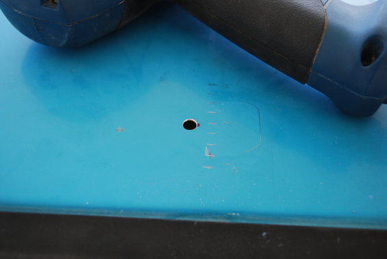

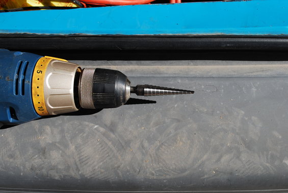

I used an Irwin Unibit to drill the 1/4" holes needed for the rivet nuts and a little step stool to help reach the roof easier.
Optional tools include homemade oatmeal raisin cookies, Coca-Cola, and streaming slacker radio.
Top view of the first hole drilled.
Bottom view of the first hole drilled.

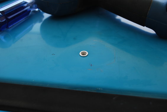

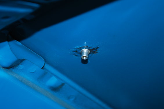

Top view of first rivet nut installed.

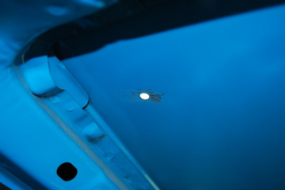

Bottom view of the first rivet nut installed.
After doing the first hole and rivet nut, the other five went very smoothly. I also put a small amount of silicone sealant around the top and bottom of the hole before installing each rivet nut and also put anti seize in the threads before installing each screw to prevent leakage or corrosion.
