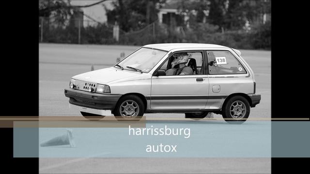

Thanks, here is a video from Sunday's autox.
The course was pretty good, I only did the afternoon session so I only got 4 runs. This is from my 3rd, 4th was my fastest, but I had moved the camera and it didn't turn out as good. This race was in Harrisburg, we normally run the Philly region events, and will be sticking to Philly region. These central PA guys took themselves way to seriously and a few of them were real jerks. They also didn't seem to have there act together as far as organization of the grid, etc.
The car did pretty well, a little more understeer than I had anticipated, but manageable. When the front started to slide I was able to correct by lifting off the throttle and the back would come around. I was also able to induce a little oversteer with steering input.
