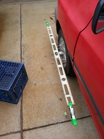

So I've set up a primative alignment tool consisting of two plastic 48" long levels clamped to the rotors.
The levels are approximately centered on the rotors and I centered the steering wheel and have adjusted the rear of the level to be 3" from the rocker panel pinch weld.
I've checked the distance from the framerail at the rear of the rotor to the outside of the level and have 13 5/8" on the driver's side and 13 11/16" on the passenger side.
The end of the level at the rear is 59 7/8" out to out and at the front is 58 3/16" out to out. The difference is 1.6875" narrower in front to rear.
I plotted this out in Autocad can came up with 1.007* toe-in.
