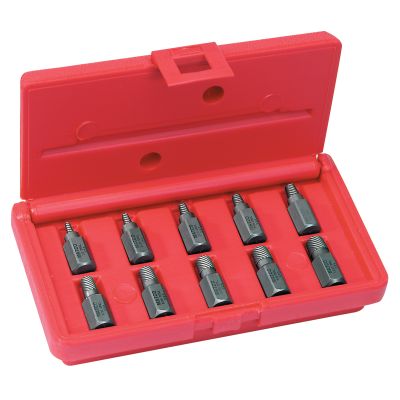

        this happened to my old festiva, they were the original plugs at like 120k on the clock!,..
        dont worry, i totally sh*t my pants when this happened to me. you just need to go see a snap-on,matco etc etc tool guy, maybe craftsmen.
        they sell a easy-out type socket with a twisted shapened end, kind of like an easy-out.
        These tools are made for this job and mine came out in about 5 minutes, it just takes a little muscle to get the tool to bite into the metal.
        this is whatcha need.
        • #19
          wow you pulled the head!? yikes! a $37.00 extractor set and 5 minutes, wala...
