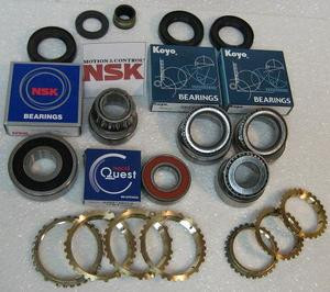

    I did some looking around for rebuild kit sources, and I found these sets:
    Festiva 1.3L T-axle Kit $94.77
    http://www.americanpowertrainwarehou...stiva-bk200ws/
    Ford Capri XR2 1.6 Turbo T-axle kit $114.77
    (CAP5T)
    ( Bearing set - no synchro rings )
    http://www.americanpowertrainwarehou...a-88-09-bk210/
    FULL!!! ( PT#: BK210AWS ) $152.77
    http://www.americanpowertrainwarehou...8-09-bk210aws/
    * 15mm thick input shaft bearing
    ~or~
    http://www.americanpowertrainwarehou...tege-bk210cws/
    *16mm thick input shaft bearing
    There may be other sources out there - in fact in the Memphis area is an outfit called TRANSTAR Transmission Products, but they didn't seem to have the kit for them.
    On the Capri XR2 T-Axle there's a question what size input shaft bearing it has. I think there was mention of a 60 or 68 mm shaft diameter, and the parts site talks about a fifteen mm thick input bearing for one kit - and a sixteen mm thick bearing in the other.
    The Capri T-axle also has a specific kit for either a turbo or a NON-turbo engine.
    The above kits theoretically have "All seals" but I saw nothing about gaskets. Gaskets being a seal by a stretch of logic, you would think the kits had them too.
    Anyone who has rebuilt a transaxle for one or the other, please jump in. This water is getting deep AND sort of expensive...
    I don't wanna send for the wrong stuff when the "Gate Fee" is over a hunnerd bucks!
    NOTE: The non-turbo Capri XR2 kit is a CAP5 vice a CAP5T part number
    CAP5 T-Axle kit, with Synchro's $138.77
    Apparently the XR2 T-axle was also used on Escape, Escort, Tribute, and Protege

        I'm looking at manual transaxles right now - I have them both in my shop, but decided to go ahead and renew them before dropping them in and finding out they were possibly shot.
        PS: It sounds like the auto trans is a tougher unit, even though it's only a three speed.
        PPS: Input shaft is what they said, see the links to the kits above.
        Oh! Wait a sec - I just re-read the parts info at the BK210AWS link, and it says "MERCURY CAPRI - TURBO ONLY" farther down the page.
        So that's the one!!!
        The kit for the 1.3L has no such glitch in it, one size fits all

          Capri non turbo has a f series trans where the turbo Capri has a g series
