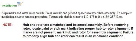

    If you're doing it on car, you'll want a slide hammer to gently remove the hub. If the knuckle is removed, a hammer and large socket, or bearing race driver is needed. Be sure to knock off and blow out any rust or debris before separating the hub from the knuckle, do one at a time, and DO NOT loose or swap the spacer ring that sits between the bearings. They must be present and only installed in the knuckle they we're removed from.

      There are no Video posted currently but feel free to try and make one when you do it. Below is a Write-Up on how to do it. I have used this guide to do the job my first time and it is pretty straight forward.
      Festyboy's Guide to replacing front Rotors and Bearings.

        It just came to me that I have done this before to this car. At the time, instead of taking the hubs all apart, I altered the back sides so I could get to the 4 rotor mounting bolt heads for removal without disassembling the whole hub. When the new rotors get here from napa [$25 each] I will look to see if anything grew back. I think it was this car.
                I'd like to see how you remove a rotor without pulling the hub away from the knuckle...
                Trees aren't kind to me...
                  ^^ Yes, the rotor is located between the hub and knuckle.
