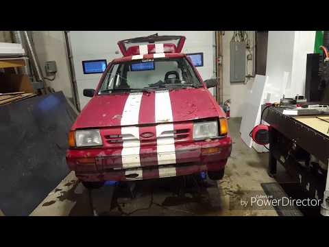

    This first post is editied to have my new how-to video which is much better than the one that I originally had here. The post below will have my old video that was in this first post before.
    So I made a video of where festivas should be rustproofed and where they rust. The time of year to do it is just before it starts snowing and the sand and salt gets on the road again.
    The video is long, but should explain everything fully. In the description is an index so you can just see a part if you like. Here is whats in the index:
    WHERE rust starts
    WHERE to apply rust preventative
    WHERE are the drain holes which need to be cleared
    WHAT to use and not to use- the end shows the cans and what the spray looks like.
    WHY to do this
    HOW to prep first time
    HOW to apply
    Ideally you would apply this really well once, then quickly once a year after that. Really well being wiping the dirt out of the interior panels, blowing all the dust out and spraying all nice inside. Quickly being just spraying it through the quickly accessible holes. Perhaps every 5 years doing it really well would be good if your in an area with bad rust.

    This is when i bought it and youll see in the video how bad it is now.
    What you dont see is underneath. Thats this:
    Save your festivas!!
