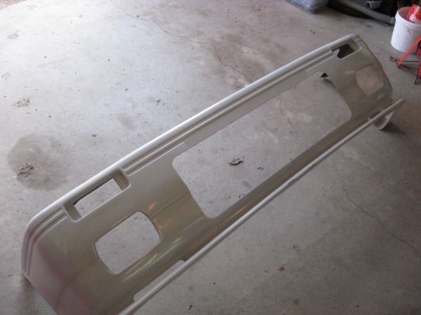

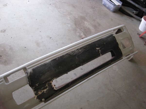

    Got some work done today on the front bumper...
    Before...
    Full size patch thanks to Grey VW...

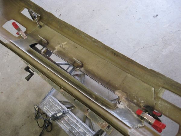

    First cut across the top...
    Second cut across the bottom...
    Patch clamped in from behind...
    Front view...

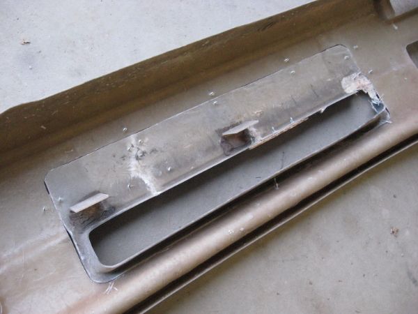

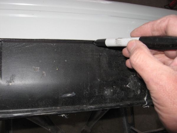

    Marking out the cut line...
    Cut along this line...

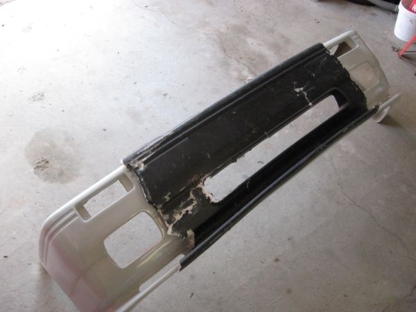

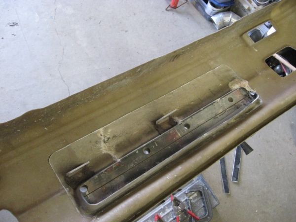

    Test fit from the back...

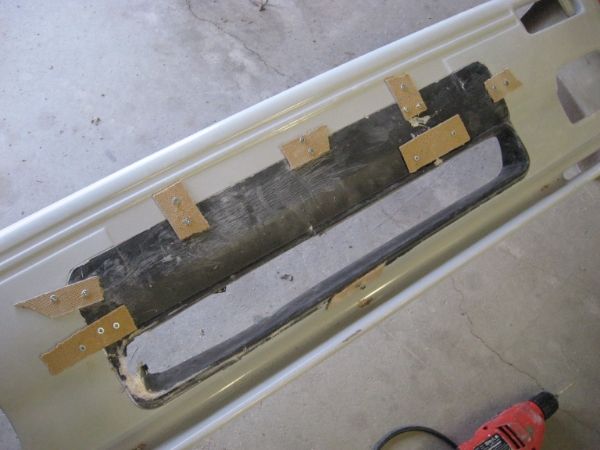

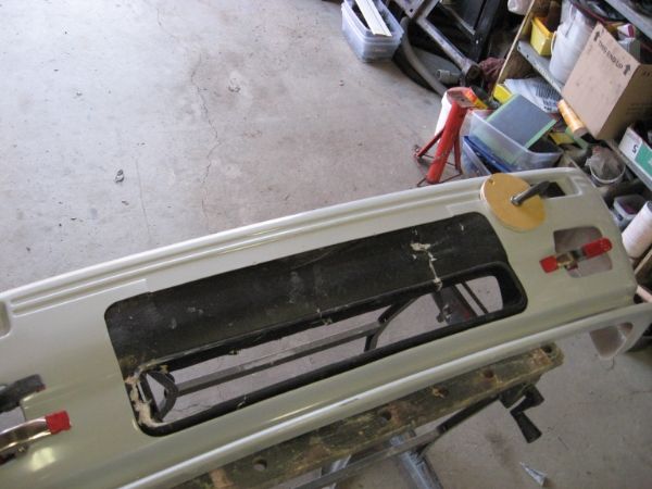

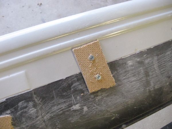

    The white bumper is an FMS version and the patch is an ATH. There is a noticeable difference in the thickness of the two so I had to come up with a method of attaching the two peices so that the front surfaces would be flush and still allow me to fibreglass the back side. Here's how I secured the patch in place...
    All secured and ready to go...
    From the backside...
    That's as far as I got tonight. Next step will be to fibreglass the back side to join the patch to the main peice and make the necessary repairs to the collision damage on the patch. Once that is done I'll pull all the screws, scrape off the little wooden joiner bits and get to work finishing the front side.
