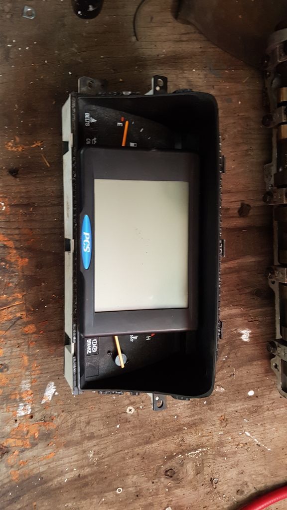

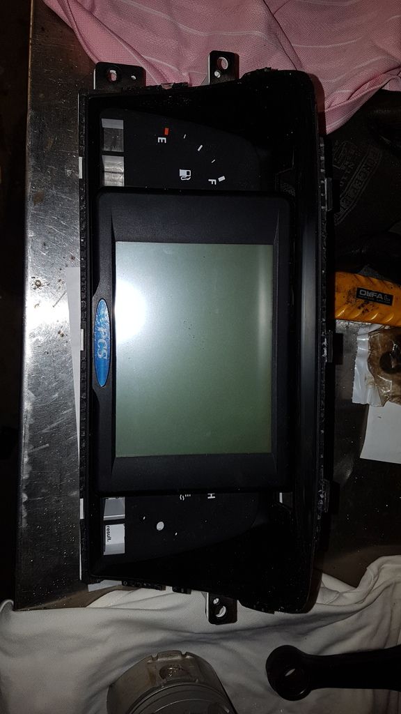

Did some mock up, I still think I'm going to use this data logger because it has inputs for fuel level, RPM etc.

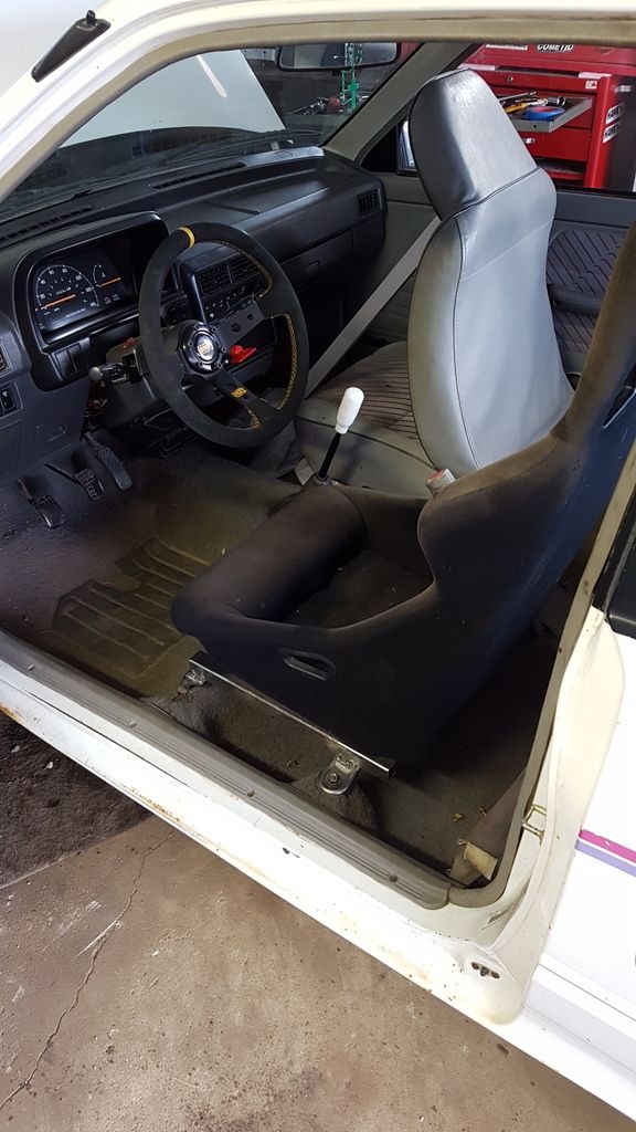

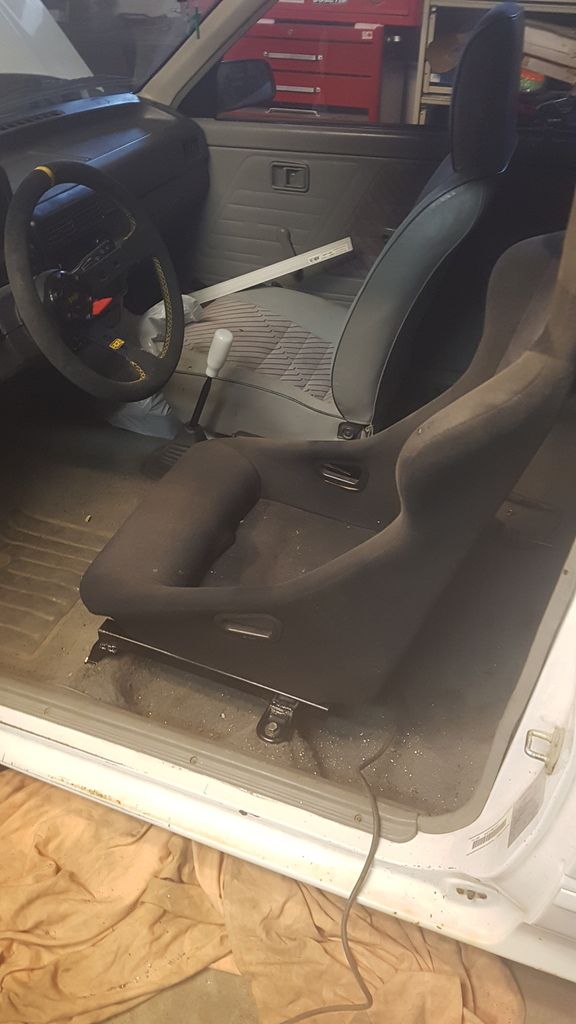

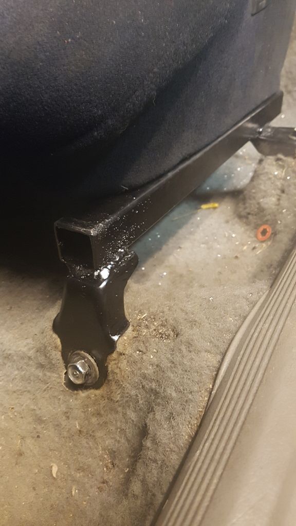

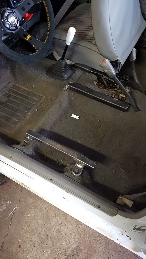

Made some seat brackets. Not horribly proud of them but I will sit very low. May as well have my fat arse as low as possible.

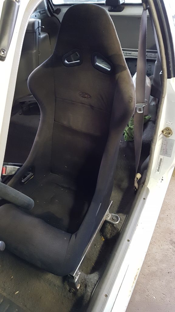

seat will end up like this

Took apart the cluster for the dash logger. looks like it will physically fit! will need some minor things to get this thing hooked up!
This is the setup!

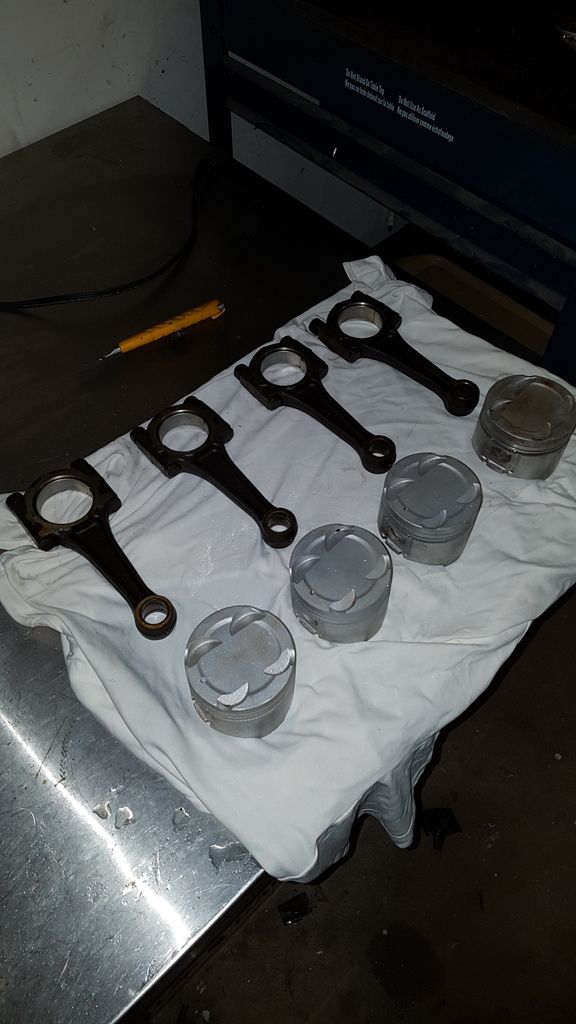

Miata b6ze 9.4-1 Pistons with my mazda 323 gtx rods

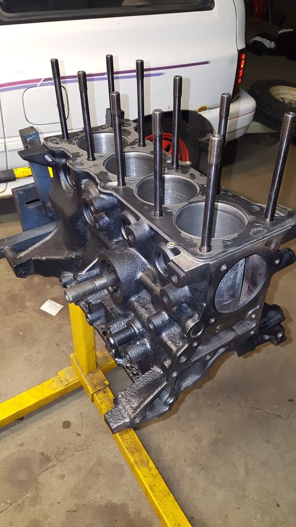

everything all cleaned up.
i was going to use my cometic head gasket. But decided against it. Will use it when i blow this thing to kingdom come. Going to try a ebay head gasket with ARP head studs.
I mean they arent exactly that pretty.. but it will work.
Weapons of choice!!! best purchases I've made. But nearly made me broke
You'll probably wish you had used the cometic gasket. The cheap gasket will leak combustion gasses into your coolant. You'll start noticing your coolant dissaperaing and you'll see oily crap in your reservoir. Be sure to re torque the fasteners after the engine heats up. I've had bad luck with fiber gaskets and ARP studs on a few engines.
Another note: when using a cometic mls head gasket, make sure all surfaces are clean and dry. Don't use any sealer on anything. That black coating is a layer of sealant. I believe it's viton rubber based.Last edited by Advancedynamix; 11-15-2016, 03:43 PM.Driving for me is neither a right nor a privilege. Driving is my passion, as it was for the people who invented the automobile, the people who paved the first roads and the people who continue to improve the automobile. Please respect this passion.

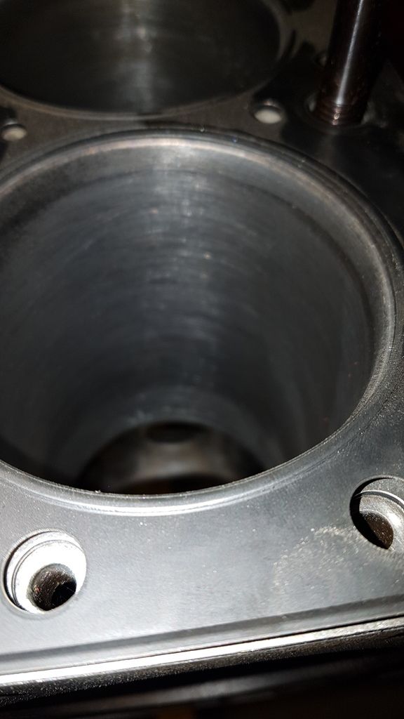

Did you have to machine the head and block? I read it was 100% necessaryOriginally posted by Advancedynamix View PostYou'll probably wish you had used the cometic gasket. The cheap gasket will leak combustion gasses into your coolant. You'll start noticing your coolant dissaperaing and you'll see oily crap in your reservoir. Be sure to re torque the fasteners after the engine heats up. I've had bad luck with fiber gaskets and ARP studs on a few engines.
No. I've had the head skimmed on all the b6 engines I've put together, but never the block. Dragonhealer puts them together without machining and hasn't seen problems. He builds so many b6 engines that he stocks several sizes of Cometic gaskets at all times.Last edited by Advancedynamix; 11-17-2016, 12:51 PM.Driving for me is neither a right nor a privilege. Driving is my passion, as it was for the people who invented the automobile, the people who paved the first roads and the people who continue to improve the automobile. Please respect this passion.
Did you just use a block sander to smooth out your block?Originally posted by Advancedynamix View PostNo. I've had the head skimmed on all the b6 engines I've put together, but never the block. Dragonhealer puts them together without machining and hasn't seen problems. He builds so many b6 engines that he stocks several sizes of Cometic gaskets at all times.
I might give it a try then.
No. I scrape old gasket off with a large planer blade (very sharp and flat) and I hot tank my blocks. I have a couple blocks that need to be surfaced because the deck is pitted, but I haven't used those for anything yet because I've been able to find blocks with good condition decks.Driving for me is neither a right nor a privilege. Driving is my passion, as it was for the people who invented the automobile, the people who paved the first roads and the people who continue to improve the automobile. Please respect this passion.
