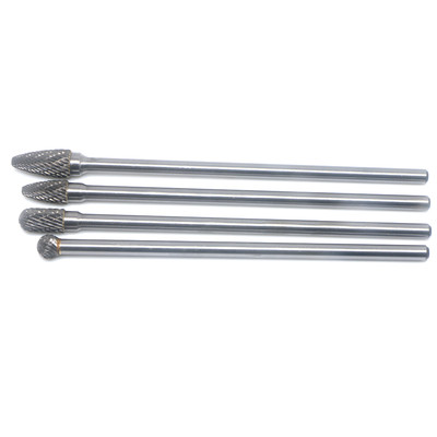

Having carbide bits is really the way to go to knock out the heavy stuff... If all you have is sand rolls, it's gonna take a while...

After only a couple minutes with the Sandpaper I decided to take Festyboy's advice and go get some Carbide Bits lol."The White Turd" 1993 Festiva 144k miles. (Winner of FOTM November 2016)
