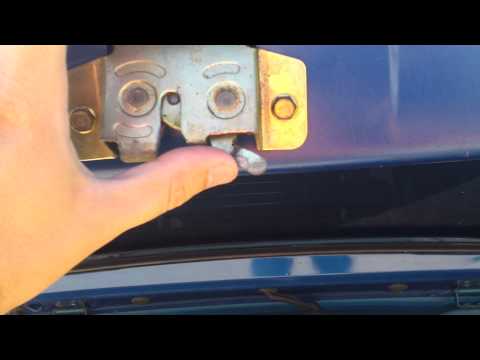

Love the yellow ones! Hope you enjoy the car! If the back hatch is locked and your key doesn't work to unlock it you can get to the locking mechanism from the inside. I can make a video sometime to show you have to do it.
