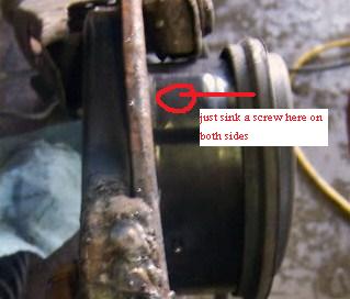

Hey all-I have been searching around on here for fixes for my linkage bushing issues. I have found some awesome info and advice but I was wondering if anyone has, or could take, any pictures of their solutions to this issue? Any help greatly appreciated. Thanks!!!

What parts do you need pictures of? I have a transaxle/shift setup sitting on the floor at the shop as we speak, and can take pictures of any specific part you have questions about on Monday.

ck...I am just around the corner from you....welcome to the site. You can get bushings that will help the issue at Autozone or advanced....they are a mixed pack of door hinge bushings....there are some in there that are close and will help alot."FLTG4LIFE" @FINALLEVEL , "PBH"

I thought he was talking about these bushings.
I believe he was Fresh."FLTG4LIFE" @FINALLEVEL , "PBH"

Originally posted by GenevaDirt View Postck...I am just around the corner from you....welcome to the site. You can get bushings that will help the issue at Autozone or advanced....they are a mixed pack of door hinge bushings....there are some in there that are close and will help alot.I take it you missed my post just before yours....lolOriginally posted by Hot_Wheels View Postooh sorry, theres also a guy on cp.com making new inserts or you can go to the HELP section at any autozone and they have a packed of bronze door hinge bushings there in a variety pack i hear thos work great"FLTG4LIFE" @FINALLEVEL , "PBH"

or get a $.99 ($10 after shipping) e-bay civic short shifter and then you'll actually have a sealed bearing instead of that bushing crap.

Thanks for all of the help and advice guys but once I got under the car I found that the bushings are not my problem. I grabbed the shift rod and it easily slid in and out of the tranny. So it would seem that I am yet another victim of the dreaded shift gate phenomenon. So it looks like there may be a new post on the for sale section of the board soon as I don't really have the space, tools, or honestly the knowledge to do a tranny swap or to take it apart and get the shift gate welded/replaced. Kinda sucks-so many years without a Festiva and I find one and it doesn't like me
