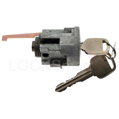

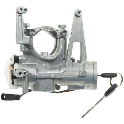

Are you talking about the key ignition turn lock cylinder to start the car? - - My key cylinder pins we're holding the key in and although it would start the car the key could loosely fall out. Today when putting the key in the ignition to start the car there are no engaging pins and the key feels that it's going into an empty hole. - - I went to autozone.com and matched the ignition lock cylinders for a 1990, same year, Mazda Miata and 323. They are LC14890 for automatic transmission at $20.99 and LA3421 for manual transmission for $269.99. I have 1990 stick shift Festy - - what's right???Last edited by meyek91974; 03-09-2016, 10:14 AM.
The automatic transmission has an extra wire on it, some sort of safety switch, probably similar to the one the manual has on the clutch pedal to keep from starting the car in gear. Given those prices it would be nice if they are interchangeable and manual's just don't connect the wire.
Original owner of silver grey carburetted 1989 Festiva. 105k km as of June 2006. 140k km as of June 2021.
According to your part numbers, the manual is quite a bit different
Manual
Auto

Neither one of the ones show in the pictures posted by eaglefreek look like my manual or my automatic.Last edited by 1990new; 03-11-2016, 05:08 PM.
Neither of those look close! Here's a stock Festiva one, not sure if it's auto or manual. The auto one will work in a manual car but not the other way around.Originally posted by Eaglefreek View PostAccording to your part numbers, the manual is quite a bit different
Manual
Auto
