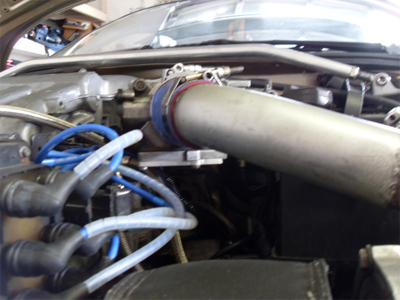

                              • Just got around to checking back in on this thread. Looks like most of your clearance issues for the TB could be solved by making an IAC block off plate. I have one on mine and have no idle issues at all. Of course, I live in South Florida so cold weather is never an issue.
